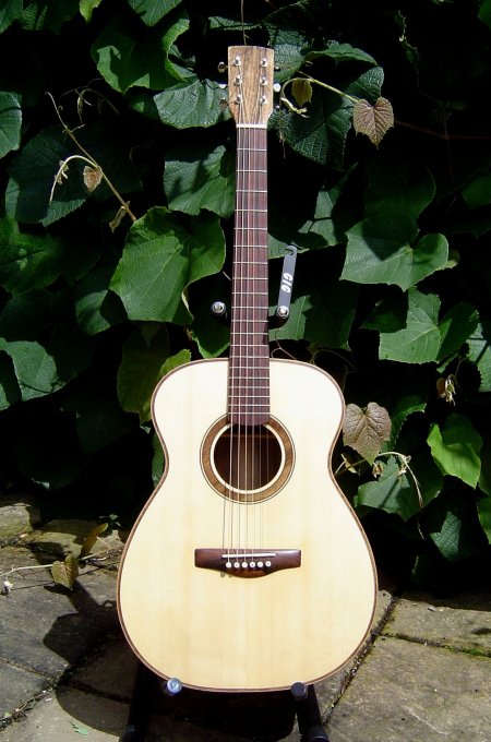

Well, I’ve finished my latest guitar an Italian Spruce/English Walnut OM. This one has been made specifically to be played in DADGad and some of the other altered tunings. It’s very much in my style, I like to keep all of the woods in the same colour palette, so this may be a bit retrained for some. Dave described it as ‘Lowdenesque’ which is good enough for me.
Top: Italian Spruce from Luiggi
Back/sides: English Walnut

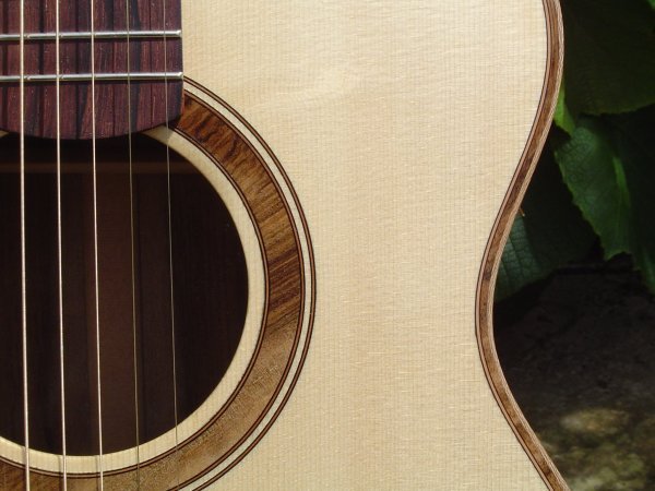

Binding: London Plane, with bookmatched English Walnut and ebony/pear/ebony purfling

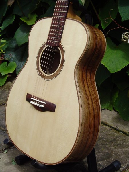

Neck: English Cherry (as is head and heel block)
FB and bridge: Madagascan rosewood
Rosette: English walnut with ebony/pear/ebony purfling
Nut/saddle/bridge plate laminate: Camel bone
Finish: French polish, of course.

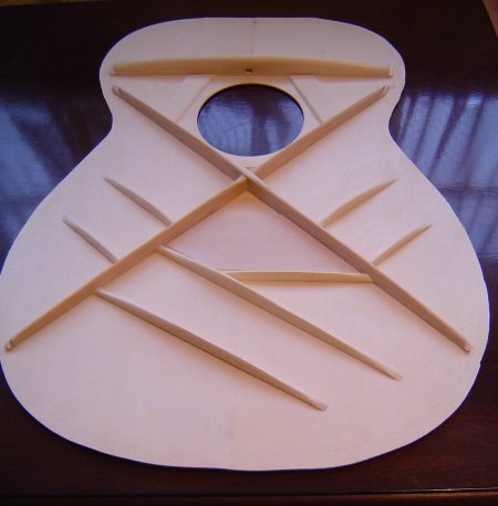

As you would expect from me the top is ‘parabolic’ braced as is the X-braced back. It uses my normal bolt on neck with fingerboard glued to a neck extension which floats
It’s set up for a very low action, to allow faster playing for some of the Celtic music it’s been built for, kind of like a steel string flamenco guitar. In a couple of months, when it’s reach full hardness, I’ll probably take some OOOO wool and oil and knock the French polish back to a softer lustre.

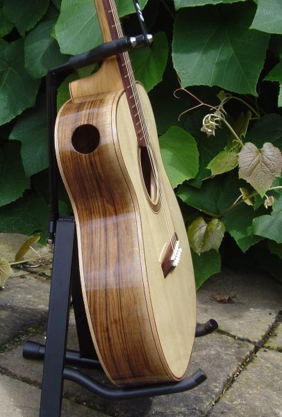

That looks fabulous!! You can't beat wood when it's as tastefully done as that. Definitely Lowdenesque looks but your own sound. Really nice for fingerstyle - it's a fast piece but you can hear all the notes across the range crystal clear.
As I said in my e-mail I hear Richard Thompson, Kelly-Joe Phelps, John James and some echoes of Martin Simpson in your playing there. Lovely piece and arrangement and fantastic guitar.
Is that the first one you've done with a soundport? What do you think of them? I really love them. Did you Tru-oil the neck in the end or FP it?

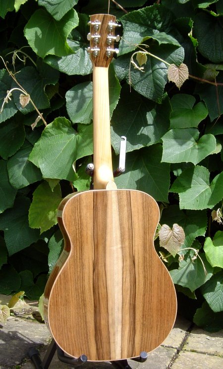

A total beauty! Where did you source the walnut?

Colin, I really enjoy seeing what the UK luthiers build, and am stunned by this one!!!! It is evocative of the British style of building, I see a similar "organic" syle amognst the likes of Russel Rose, Dave White, and also reminds me of some of the Brook Guitar and Lowden range.
Totally right up my street with regards to appointments, design, etc.
What a well-balanced tone and response! The crispy sweetness of the sound of Walnut back and sides is something that is growing on me, especially with my walnut cittern.
Well thanks, Colin. You British builders really inspire me.

How did you arrive at that port hole size?

As one not too averse to bling, I can still appreciate the beauty in understatement. There's "Needlessly Spartan", and then there's "Elegant Restraint". You nailed the latter.
The color of that English cherry is remarkable. Looks nearly like a light mahogany, or dark maple. It matches the sapwood in the back perfectly.
AND---is that a double line of walnut in the purfling?

Is that a standard OM shape, or is it your interpretation? It looks a little different to my eyes, but that could be the purfling I guess.

I think I like the OM shape you have with this one versus mine. Is it yours?

Thanks for your kind comments everyone, most appreciated. I'm pleased with the sound of this one and as you know that's the main thing for me. I think I've got my bracing scheme finally the way I want it. And, the walnut just seems to let the top do its thing. For DADGad I need to have a big fast sound across the board, but with clarity, so far this one seem to be producing.
Dave, yes it's the first soundport I've done from scratch, though I have retro-fitted one to a couple of earlier guitars, I like the effect enormously. The thing I like about you Dave is that I get comparison to Lowden and Richard Thompson in one posting! Life doesn't get much better. Yes, True oil on the neck, following your programme.

Steve, the English cherry has become my favourite neck wood, it's a little denser and heavier than mahogany but seems to add a lot of controlable sustain. the pics didn't really bring out the beautiful range of colours in the cherry. No, binding is London Plane then the purfling is Walnut ebony/pear/ebony.
Body shape is my own adaptation of the pre-war Martin.

I wanted to ask you about your bracing. The ends don't taper much and I am curious about how you get the excellent bass notes. Could you possible give their maximum height and thicknes, and the thickness of the top around the soundhole.
I thought I did a porpoise style brace profile, but mine is really not much like yours at all.
